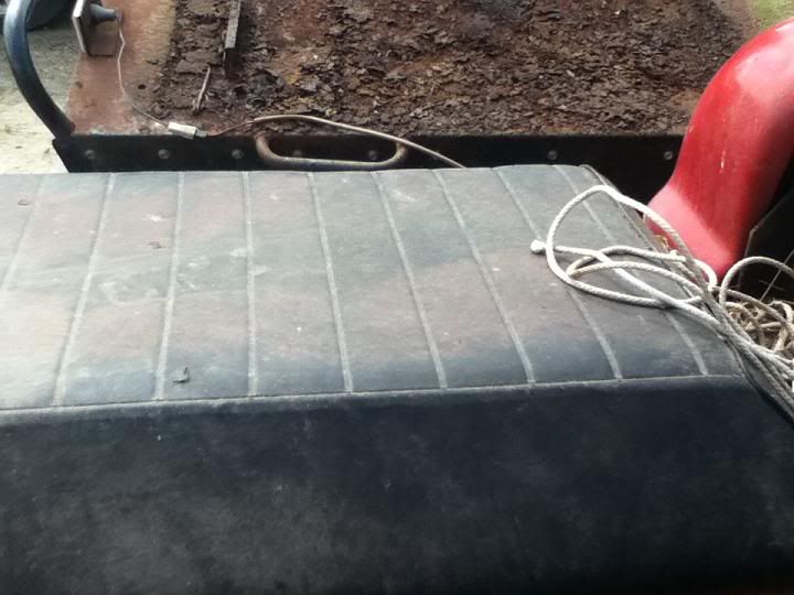

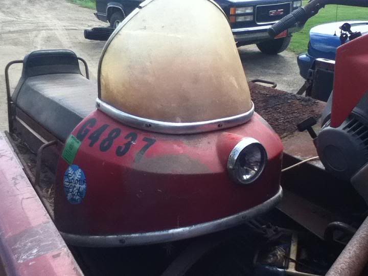

i need to know everything there is to know about em  ;D

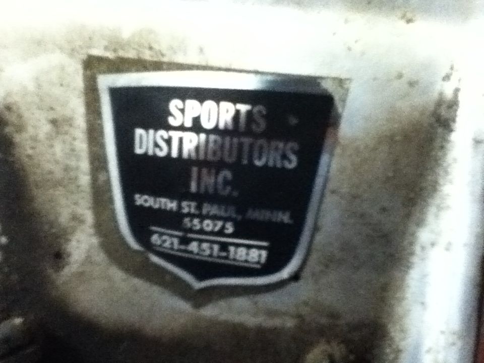

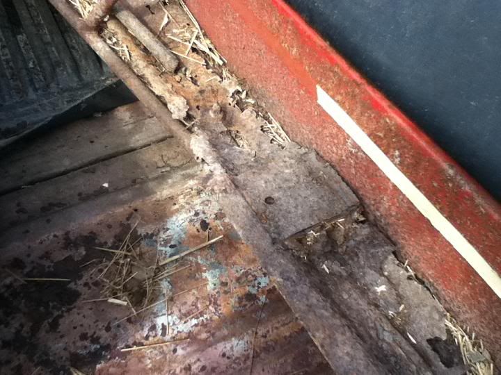

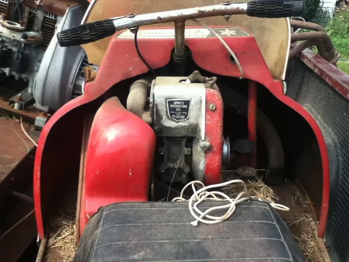

my father and I are starting to tear into our barn find flake and need help finding some parts.

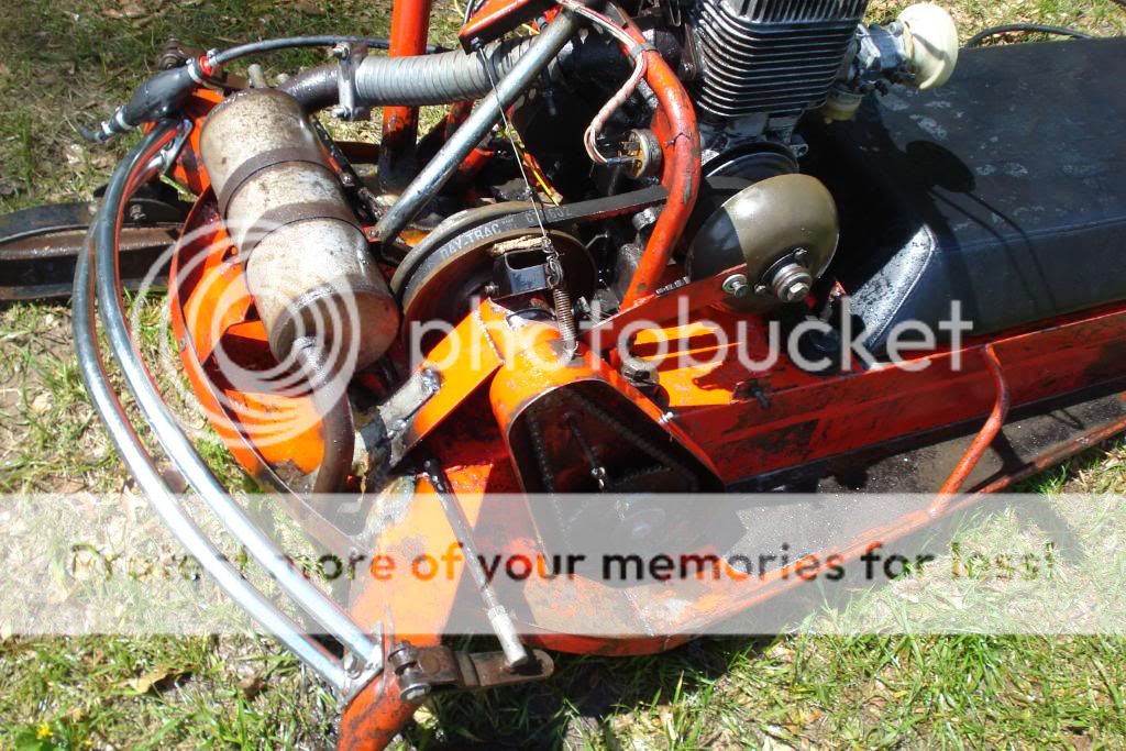

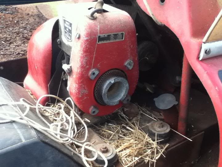

what kinda clutch is this? how do you take it off? special puller?

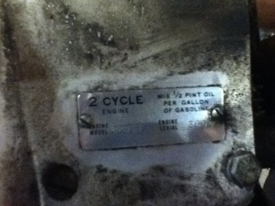

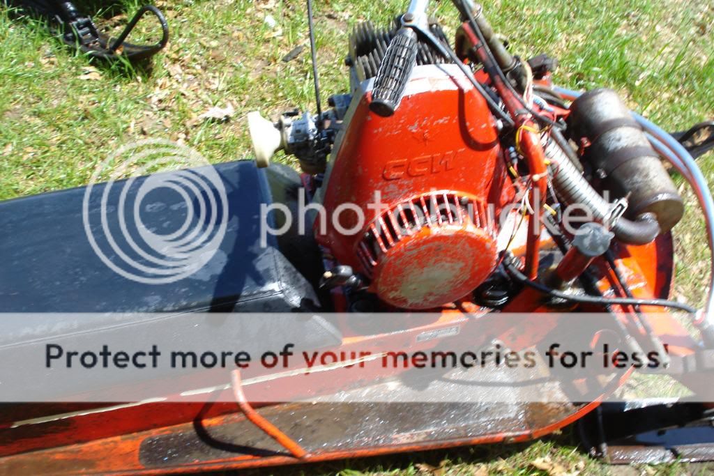

what kinda motor is this? model # 82015, ser # 2605
carb kits still available? its a hl189a

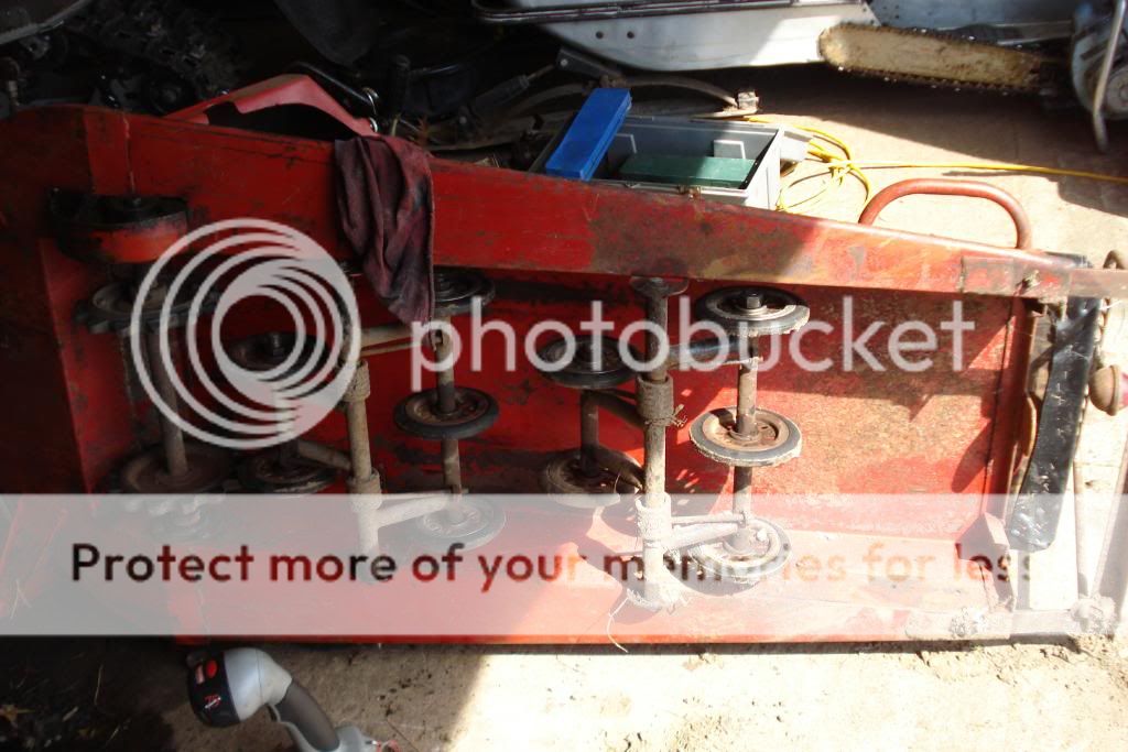

the main thing i need is a track, it measures 92" x 15"
any leads on parts would be greatly appreciated
thanks alot
cody

    Looks like a 500 series Sally, mine was broke so I removed it w a sawzall, you might try someting else. I don't think there is any threads inside for pulling, maybe a large jaw puller?
    Find a track and drivers from a sno pony, a little easier to find.
    No help on the motor, mine has a ccw.
    Careful w that clutch, finding the right 500 sally is no easy task.
    fp1967
    • Posts: 1753
    • U.P. of Mich
    Re: snowflakes
    « Reply #4 on: August 23, 2012, 02:09:43 am »
    You will probably have to put threads in the clutch so you can use a bolt as a puller. I wouldn't try a jaw puller, most of the time, the clutch is stuck way too tight for one of these to work. I tried this once and it didn't take much pressure and the sheave was starting to bend.

    Cody, you have a 134cc Chrysler engine.

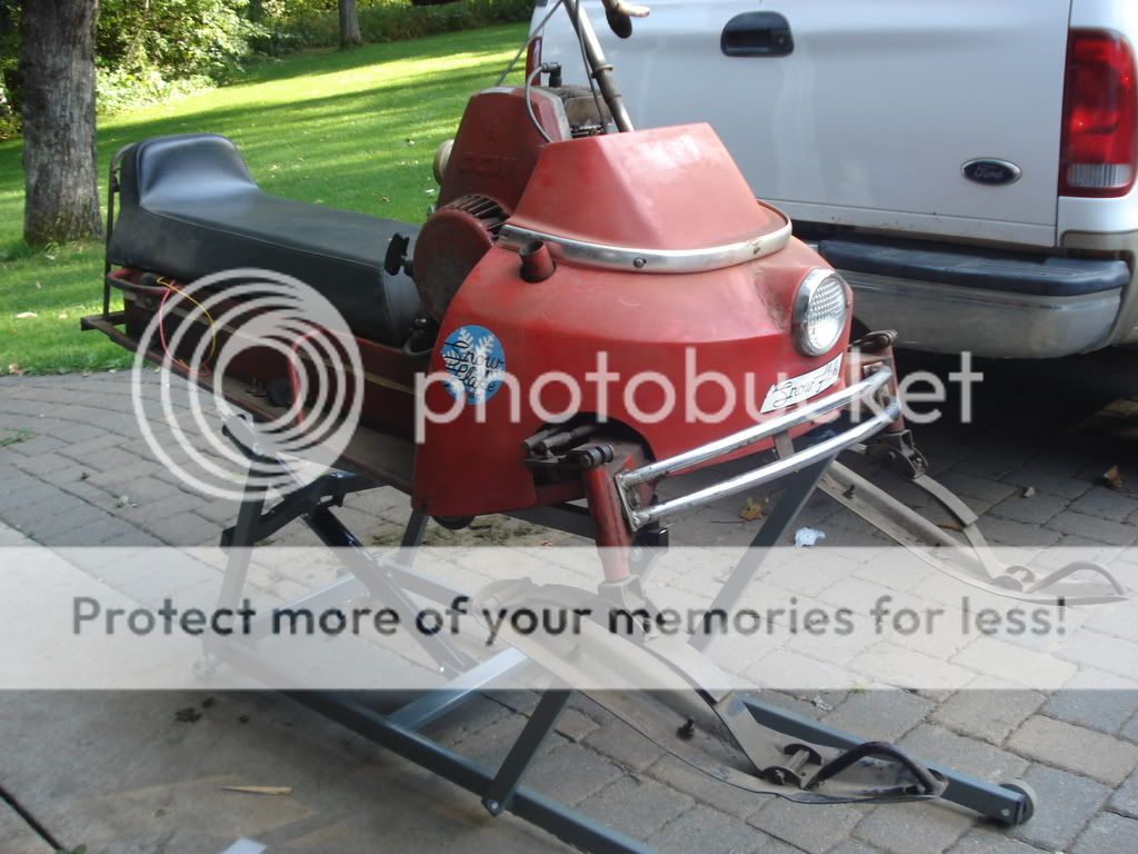

    I think they are pretty much a blue sno pony, made by the same company

    Not mine, but the coolest one I've seen.  From Waconia this year.  I might be biased though :-)  A Chuba Brothers creation . . .
